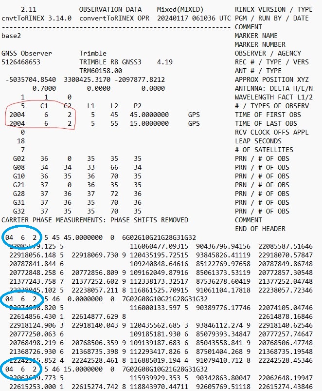

I'm going in the field next week so don't have time (or money) for warranty/firmware updating so I want to try your workaround of editing the date in the observation file. The only problem is I'm not confident about where/what to change in the file!
I have converted the .TO2 file to RINEX using ConvertToRINEX v3.14.0. I am attaching a screenshot of the .04o (observation) file. Is it literally just a matter of editing the numbers in the red rectangle markup i.e. Year/Month(?)/Day(?) with the correct date? Do I also need to change the time?

You are partly correct.  You will also need to also change the date for each observation/epoch (see screenshot below).  You will not need to change the time.
I do a "replace" in my file editor (eg: Notepad).  I first check the start time (=time of first obs) and end time (=time of last obs) for the YYYY  MM  DD.  [In New Zealand a long observation sometime straddles the UT 0hrs, so we can have different start/end dates.]  Then I use "replace" and "replace all" for the observation YY MM DD - in your example it will be 04  6  2 change to  24  1  1 (if the true obs  UT day was Jan-01-2024 which they were probably not!).
Be careful of the spacing - in your example the month and day unit are single digits.  So there needs to be a space for the MM and DD as if they were double digits.  So the correct format for the observation dates is: YYsMMsDD - where s = a single space.  Note also that some RINEX versions are different - v3.02 puts the "0" spacer in and has the full year eg:  2004 03 02

I edited the observation file as you suggested @Brent George. Carefully matching the number of spaces! I submitted it to AUSPOS just to test that it would work. It came back with an error. (Dang!) I'm hoping it might be because the file was short (~15 mins) as I was just testing the instrument to troubleshoot. I've emailed them to see if that could be it.
