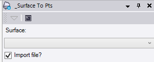

If i understand your question correctly there is a command in TBC call "Surface to Pts" which will do what you are looking for.
Michael Shipione's profile image
Michael Shipione
Thanks Andrew!  Yes, I just installed the latest version and found that under the Unlicensed tab.
