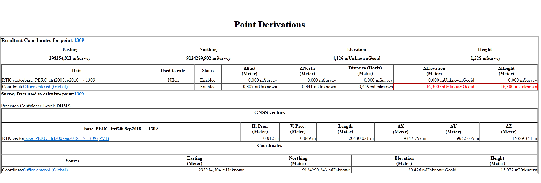

hello everyone!
I've been encountering -for me- a new error . After processing baseline, I get a red flag on my static observation and the point derivations report indicates, that there is something wrong with "Unknown geoid". Do you have an idea, what that might be? Never happened to me before.

Is it possible that point isn't in the horizontal area that the geoid model covers?

It appears that the quality of the point is unknown.  View the properties and set the point quality.

@Kenneth Watterson you are right, it is the matter of the point quality, thank you!
