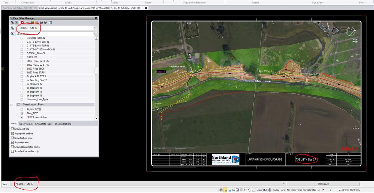

No doubt this has already been covered somewhere in here, but keen to know whether it's possible to have the view filter change to match the sheet view for a given sheet set?

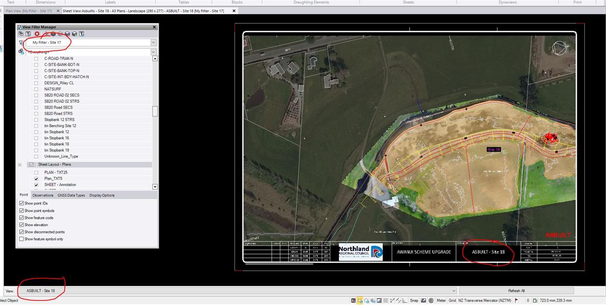

To be clear, I associated a given view filter with a Dynaview, which I then associate with a sheet set e.g. Plan Grid Sheet Set. When I cycle to a different sheet set, the view filter  has to be manually changed to match the new sheet.
May be that I've missed something here and happy to be corrected.
