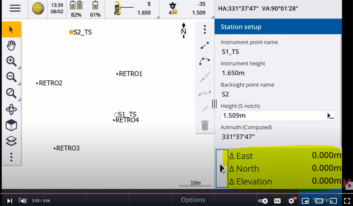

I find it strange that a "bad" station setup with high computed N/E/Z residuals is not one of the flags you see in TBC when you first import a job file.
Either in TBC or in a Job Report, is there a way to quickly see the N/E/Z residuals for each station setup?
I'd be looking for the values I've highlighted in the Access screenshot below. I know you can see it when you do Station Setup, but can you still see it somewhere in Review Job on Access?
And where can you see them in TBC? Thanks!

In Access, you can view the residuals easy enough by scrolling down to the station setup entry:
Unfortunately, in TBC, I cannot find anything that is as succinct. The closest I can find is the "point derivation report" command. In TBC, if you right-click the point representing the total station, it will generate a report with residuals for each observation used in the setup (but not a summary for each point like in Access). Pretty close, but not quite a nicely presented as in Access :-)
