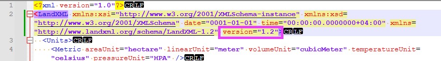

Ronny Schneider  Best Answer
That was a bit of a brain teaser again. I can confirm that the file loads properly into 2024.00 but not into 2024.10. It completely crashes the transaction manager and you have to reload the project.
The importer is missing the LandXML version information in the header. If you add the following, somewhere in that line, it will import. Previous versions are more forgiving.
Since Trimble chooses to ignore all bug reports/description from the forum I've forwarded it to our dealer, so they can open an official ticket and maybe it's going to be addressed next year, if at all.
Potentially they're going to say that your software is at fault by outputting a non-conforming XML header. Just speculating, I'm not that familiar with the XML standard.
