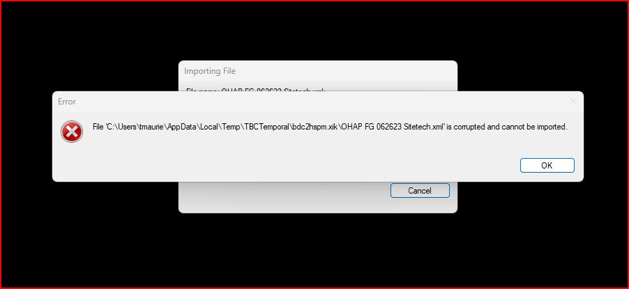

Hello, This error occurs when importing the attached file from an Agtek user. Has this been a problem for others?
Thanks in Advance,
Tom

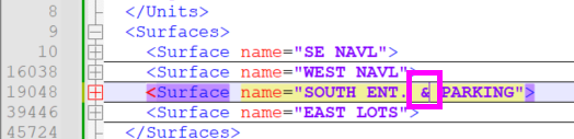

The issue is the "&" in the name of the third surface. If you remove that it will import.
That format is probably not supported by TBC. Try converting it to LandXML or a DXF first.
My bad, it actually is supposedly a LandXML. I'll have another look at it.
