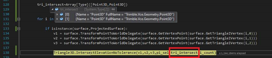

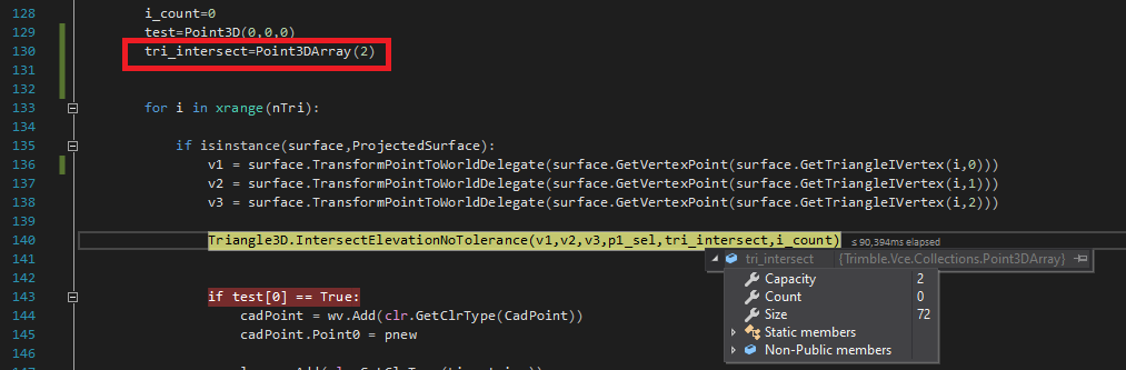

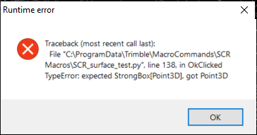

    I've run into an issue with the TBC macros now a few times. Some Geometry functions expect a declared array as input or output, but the way I try to do it I get a "Strongbox" error.
    But defining it those three ways doesn't work.
    I assume that it is the array that triggers the error and not the v1,v2 or v3.
    How would I have to declare the array that it would be accepted?
    Thanks in advance.

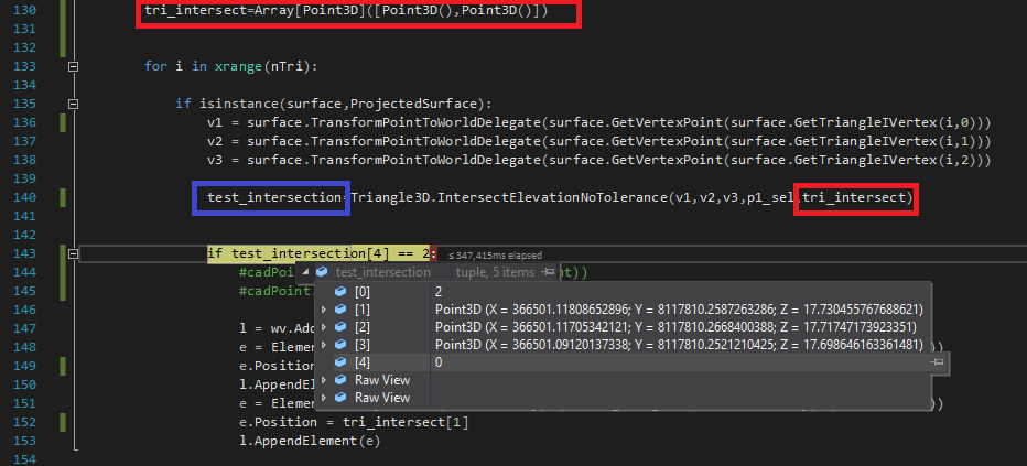

    Python doesn't have "out" parameters so don't include that argument in the call. "Out" values will be returned from the function call (along with updated "ref" values)

    This bit of code seems to work....
    pts = Array[Point3D]([Point3D.Undefined, Point3D.Undefined])
    p0 = Point3D(100,100,100)
    p1 = Point3D(150,100,110)
    p2 = Point3D(120,130,130)
    rtn = Triangle3D.IntersectElevationNoTolerance(p0, p1, p2, 105.0, pts)
    if rtn[4] == 2:
            # two intersections found
            # line end points are contained in the "pts" array
    Gary Lantaff

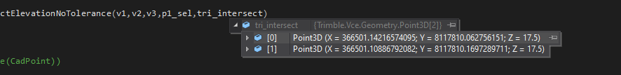

    Thanks Garry, I had found it myself after some time and created a new post but must have gotten sidetracked and didn't actually post it.
    After lots and lots of iterations I finally found the issue. The Object browser led me completely into the wrong direction.
    The countX, the actual result, needs to be outside the brackets. And it isn't just an integer as shown above but an array that again includes some of the input values.
    The following did finally work.
