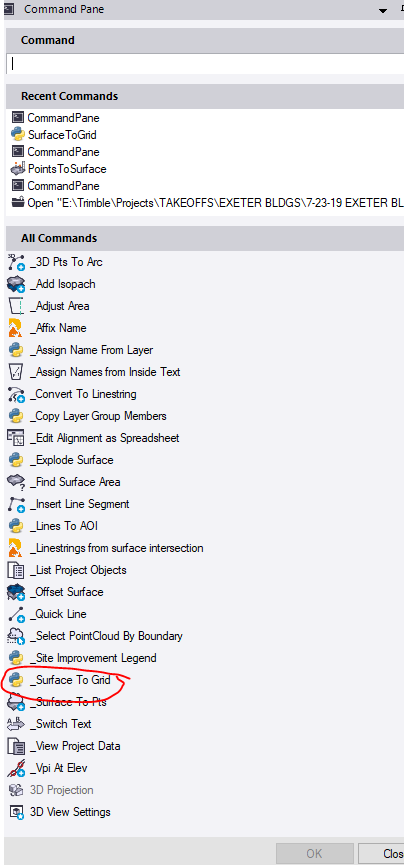

  • 8.  Re: Creating a grid of points on a surface
    Posted 07-29-2019 07:09
    https://community.trimble.com/groups/trimble-business-center-hce/blog/2019/06/20/tml-tmlstatus
    Try downloading this to make sure that Macro is installed. Then you should just be able to push "F12" then type surface or just look on this list. TMLs should all have a "_TML NAME"
  • 9.  Re: Creating a grid of points on a surface
    Posted 07-30-2019 01:04
      |   view attached
    I tried. No success.
    I tried rebooting TBC, still no success.
    Please see attached.
    Attachment(s)
    docx
    TML Status.docx   206 KB 1 version
  • 10.  Re: Creating a grid of points on a surface
    Posted 07-30-2019 06:45
    I see it on your list. Does it just not let you use it? _Surface To Grid?
  • 11.  Re: Creating a grid of points on a surface
    Posted 07-30-2019 20:53
    Now it is working.
    Thanks.

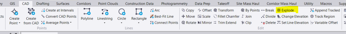

  • 13.  RE: Re: Creating a grid of points on a surface
    Posted 12-12-2020 02:39
    How do I explode?
    Liteboho Raymond Montsi
  • 14.  RE: Re: Creating a grid of points on a surface
    Posted 12-17-2020 09:14
    Highlight the grid created and use the Explode command under CAD-Edit. It will then create CAD Points in each tick marks.
