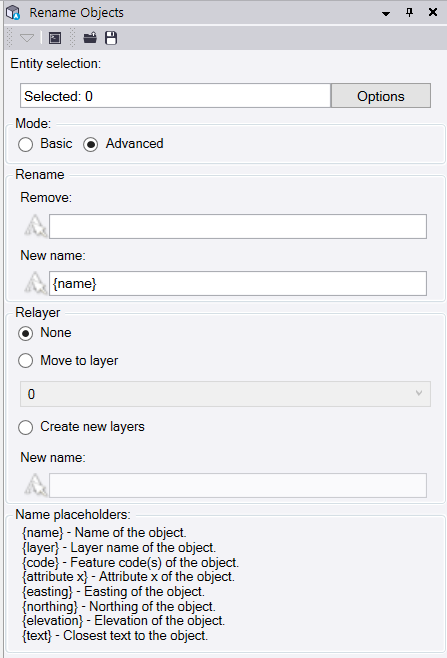

    If you have a Toolbox license you can use RenameObjects to achieve this:
    Just switch to advanced mode put {layer} as your new name.
    https://tbcanz.com/docs/Rename_Objects.pdf
    https://www.youtube.com/watch?v=QsLoHWwNJDg
