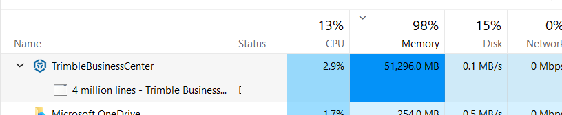

thanks for looking into this.
Initial remark, due to very strict IT rules in our organization is updating TBC a literal p in the a. Because of that, and nothing of vague interest regards CAD/corridor/earthworks/surface/IFC/drafting being mentioned in the release notes, I'm still on 2025.10.
I've also uploaded my bug tracking document with more than 40 unactioned topics there. Basically copy/paste of what I sent to our dealer, random order though.
The 4 million line project is not a typical use case but can happen when I need to separate Geotech IFC objects.
Main purpose is to demonstrate the sluggishness of the system with high line/segment count and should be a good sample to investigate and chase down quite a few bottlenecks.
