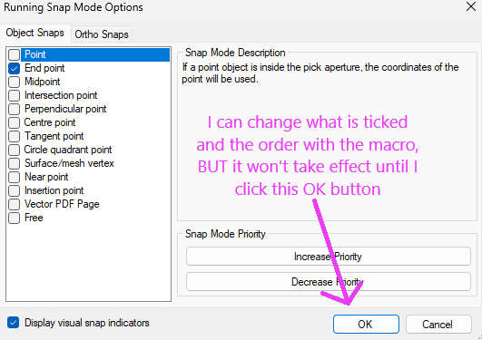

    In the other post I claimed that setting/changing the snap modes does work. That was a bit premature.
    I'm able to retrieve the current active snap modes and I'm able to write back a changed list.
    self.snaplist = InputSettings.GetSnapModes(self.currentProject.Guid) # order/priority and enabled/disabled of snap modes
    # do some changes to the list
    InputSettings.SaveSnapModes(self.currentProject.Guid, self.snaplist)
    And I can see the changes in the usual Snap Window,
    BUT they don't take effect until I click the OK button in that window, which currently renders the macro useless.
    I guess I somehow need to force the project to reload those settings?

    Thanks for that Bryce,
    that made it work.
    I had played around with InputSettings.RunningSnaps as well, but only looked for changes in the menu.
    In fact, if you only want to change the snap modes and don't care about having the menu UpToDate then you only need to set InputSettings.RunningSnaps.
    But if you want both to match then you'll have to set
