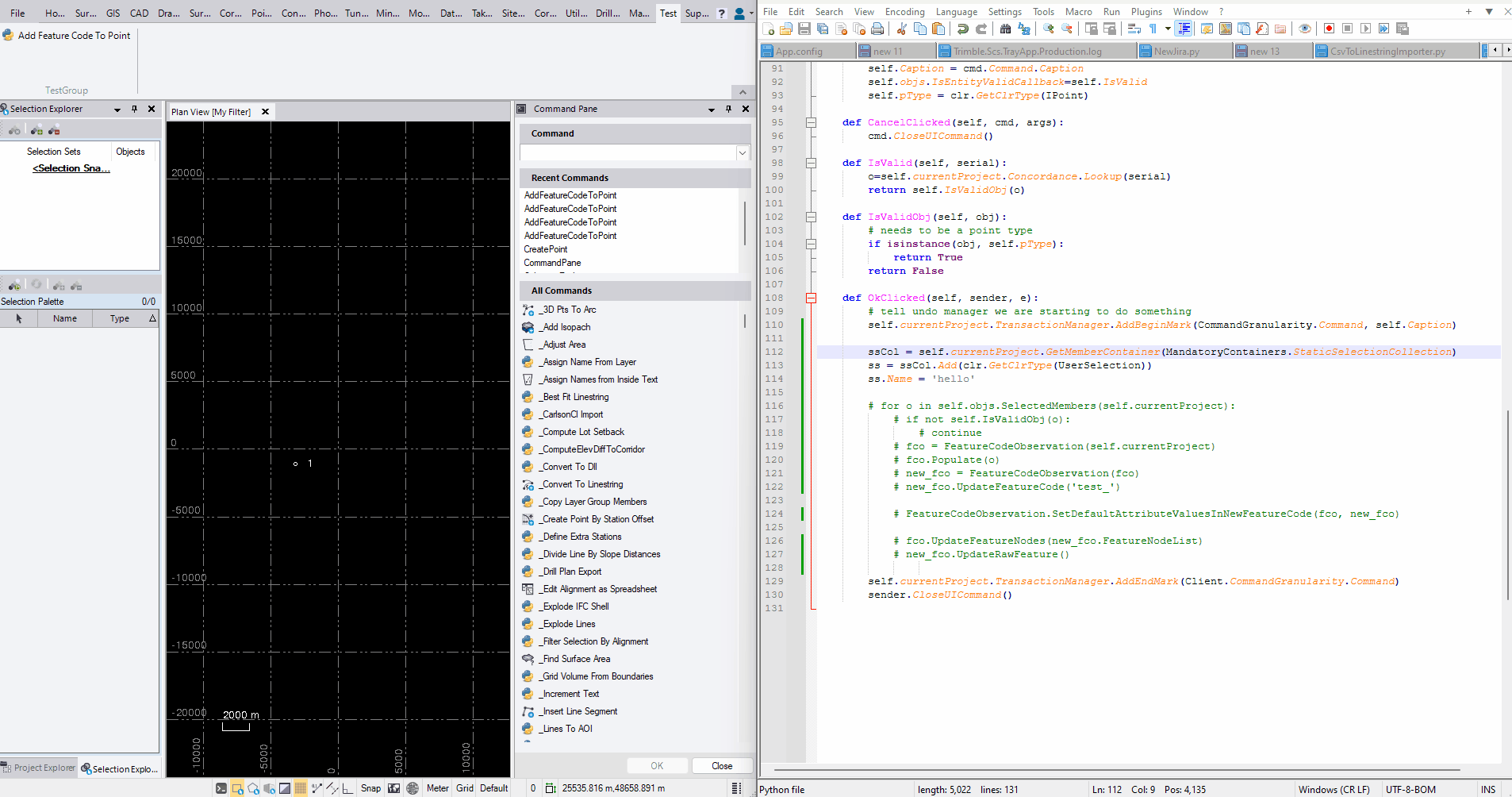

    Hi David,
    Trying to understand your issue.
    When I execute a cmd that adds a user selection to the StaticSelectionCollection, I see the selection set explorer update.
    ssCol = self.currentProject.GetMemberContainer(MandatoryContainers.StaticSelectionCollection)
    ss = ssCol.Add(clr.GetClrType(UserSelection))
    ss.Name = 'hello'
    Attached GIF with behavior.
    Bryce Haire

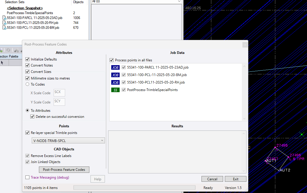

    Thanks for the reply, Bryce.
    That cleared it up. I had to make a few changes, so I am not sure what did it, but I suspect it was because I acquired the selection set collection via the ISnapIn collection on Project, instead of using GetMemberContainer.
    Since I didn't know GetMemberContainer existed, you've been doubly helpful.
    The selection set below appeared just before the dialog opened and it appears as an item to process, just as I wanted.
    David Brubacher
