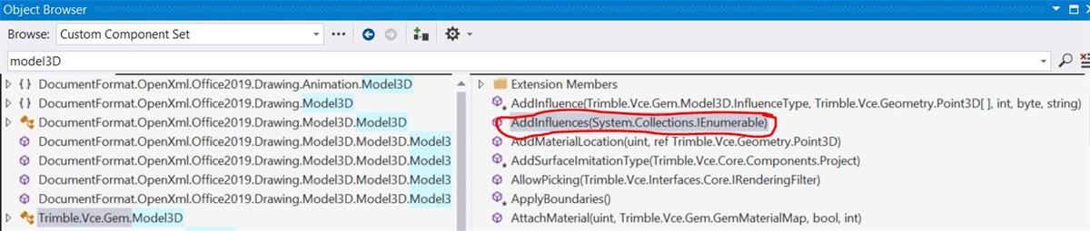

    It throws an exception on me. Are you refereeing to "Trimble.Vce.Gem.Model3D.AddInfluences(System.Collections.IEnumerable)"  since I'm seeing two overloads here (below)
    Model3D Libarary
    I suppose the reason the "addtosurface" is defined as a list is to create an IEnumarable Collection  while it creates IronPython.Runtime.List (below screenshot). I understand that the List class is implementing the IEnumarable in .NET, However I'm not sure whether The IronPython.Runtime.List is comparable to System.Collection.IEnumarable?
    Is that the reason that it throws an error on me? Wrong Data Type or I'm missing something else?!

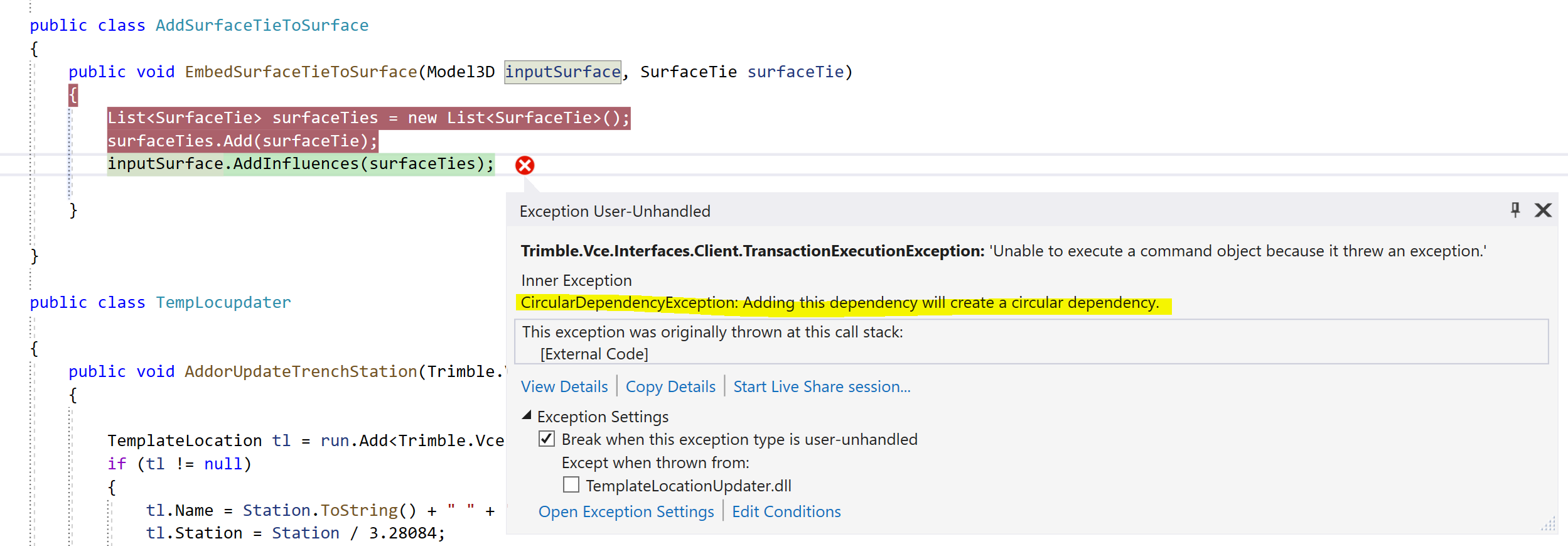

    I also redid that in C# to get the exception type since Python didn't give me enough info about the source of the exception:
    Morteza Kiani

    I've tested it now and my code works fine in Python.
    For the rest I'm the wrong person to ask. I'm not a developer and have near to zero knowledge about C or C# and how they implement lists or variables.
