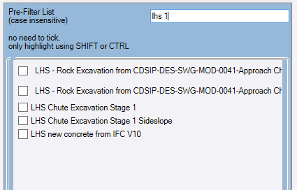

    I want to create me a macro with two lists, layers and surfaces, side by side, both prefiltered like this.

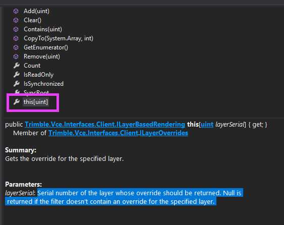

    Please take a look at the LayerOverrides property on the IViewFilter.
    This contains the serial number of the layer in question, with a return type of ILayerBasedRendering. This interface has a Visible property on it that corresponds to the one in the View Filter Manager.

    I've quickly tested it for Layers, and it works. Still took me a minute. Did learn something valuable new that way, since I had overlooked the following.
    I'm pretty sure I've never seen an object being returned like this yet. Looks like addressing a cell in an array.
            activeForm = TrimbleOffice.TheOffice.MainWindow.AppViewManager.ActiveView
            activeViewFilter = self.currentProject.Concordance.Lookup(activeForm.ViewFilter)
            loverrides = activeViewFilter.LayerOverrides[8] # test with serial for layer zero
            loverrides.Visible = not loverrides.Visible # test just negating it's current state
    So far it was always calling a method with a serial number as argument, i.e.
    self.currentProject.Concordance.Lookup(sn)
    Yeah, these are collection types that act very similar to an array/dictionary/key-value pair where you can shortcut if you know the key. A lot of our container types (including Concordance) have this functionality.

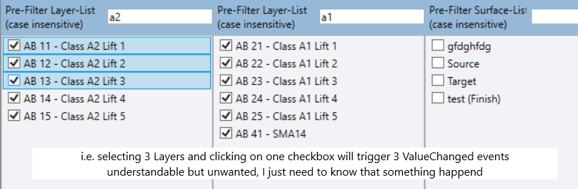

    have you got an idea/suggestion how I can avoid being hit by potentially dozen/hundreds of events if I change the check state for multiple tick boxes in a Trimble.Vce.UI.Controls.Wpf.CheckedListBoxEntityPicker?
     I only need the state of the ListBox after all the changes have been applied. Using the event ValueChanged I get one for each tickbox that got changed. I just need something like one "statechanged".
    I may have found a rather inelegant solution again, by using a timer. Setting the initial timer on startup and then compare and potentially reset on event trigger. And only run my code if the time difference between the events is larger than a threshold.

    Woof, yeah, I'm fairly confident there's no silver bullet in that control for what you are looking for. You may be stuck with the glut of events.
    One thing you could try is not using the control. Maybe bundling them in a transaction and attaching to the CalculateProjectEvents (Trimble.Vce.Core) and subscribing to the CalculateProjectEvent. This should fire when the TransactionManager AddBeginMark/EndBeginMark are fired.
    In your case, you probably wanna subscribe after you start the transaction, and then wait for the callback when the calculation is complete.
    I did verify that in the PropertyGrid, if you change the same property on multiple entities (ie 5 points selected in the project, change layer), it only fires the 2x (vs 5 times potentially in your case).
    Something to look at but may be more of a headache than you want. This also may totally not be what you want lol.

      |   view attached
    Thanks for the input.
    Separating all those different events was quite tricky. I need to keep my window up-to-date if the user selects another view, selects another viewfilter or changes the viewfilter.
    But I've got it working quite decent now.
    There is still something weird though. On startup of the macro I restore previous settings.
    For some reason I can't set the attribute "SelectedSerialsX" for Trimble.Vce.UI.Controls.Wpf.CheckedListBoxEntityPicker. Once the macro is up and running I can set it without issues.
    Running the method "SetExcludedEntities" during startup works on the other hand. Once the macro is up and running the list is already filtered based on the saved settings. But the checkboxes can only be set once the macro is fully loaded.
    I've tried to bind that particular code to self.Loaded or CheckedListBoxEntityPicker.Loaded or CheckedListBoxEntityPicker.Initialized, but no luck yet.
    Not a big deal, I've added a button that will set the checkboxes once the macro UI is fully loaded.
