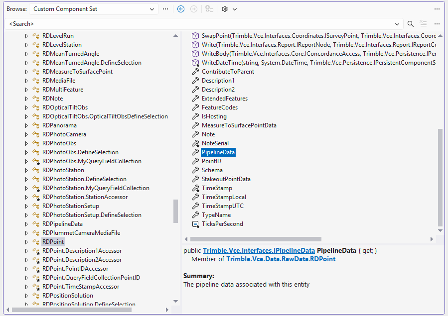

    Try looking at
    RDPoint.PipelineData in Trimble.Vce.Data.RawData (Assembly Trimble.Sdk.RawData)
    Bryce Haire
