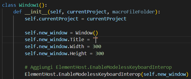

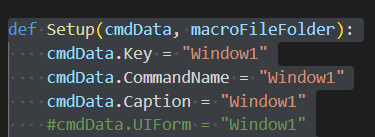

    I was trying to do something similar. I am not sure what you are trying to achieve but I was able to manage a floating window and textboxes keyboard entries in this way:
    Andrea Zanetti

    How did you reference the System.Windows.Forms.Integration, it complains that it can't find "Integration".
  • 5.  RE: modeless/non-modal window with textbox/datagrid entry
    Posted 09-24-2024 12:05
    clr.AddReference('WindowsFormsIntegration')
    Andrea Zanetti
  • 6.  RE: modeless/non-modal window with textbox/datagrid entry
    Posted 09-24-2024 22:08
    Thanks, very unusual reference for this one.
    But it all works, awesome, thanks for that.
