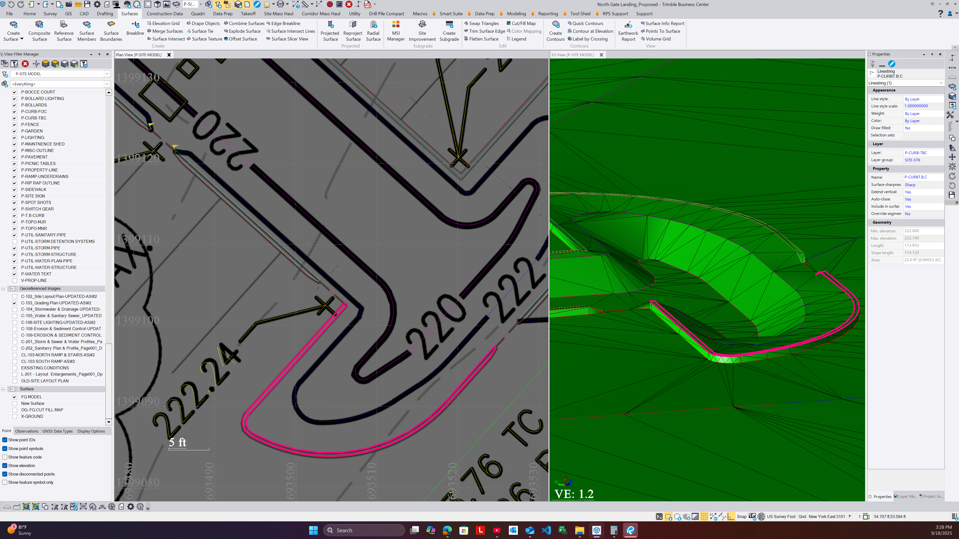

    All,
      I am on TBC 5.60, While modeling in Tbc I have lost all cad grips completely. I don't know what I am doing to cause this, it's beginning to be an issue, today I have been on TBC for about 5Hrs and I have had to restart the program 3 times to get the cad grips to come back. see attached screen shot below.

    Haven't been able to reproduce it with my test dataset yet.
    Just as double check, the line shown in your screen shot stopped showing grips and will show grips after a TBC restart?
    It's not that the line vertices have been changed to point based, because those don't show grips.
    The line is a simple poly-linestring, no smoothed segments. With the later one I get weird results depending on which segment (start or end of the line) I click, including no grips showing, even in older TBC versions.
    You lose grips for each and every line in the project?
    When you lost the grips, what happens if you open another plan view window (without TBC restart), do the grips show in that one?
    After losing them, what happens if you go to options and disable/enable grips or the number of adjacent segments?
