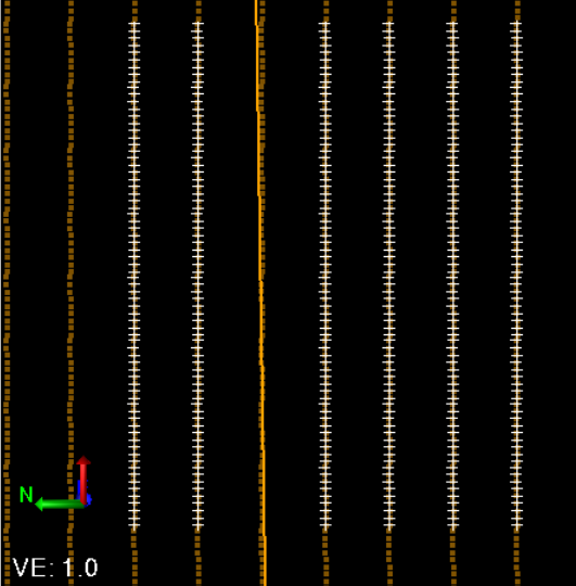

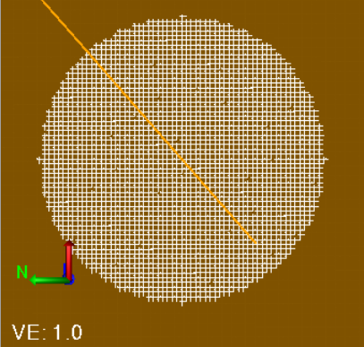

I've just tested it, and the issue remains in version 5.90. The above mentioned method takes a selection of a point cloud and filters it by the entered thresholds.
The resulting "included" list doesn't include points with a horizontal distance of exactly zero.
Purple is the point cloud (1 by 1 by 1 mm grid), orange the selection that went into the macro, and white are the cad points that got created by the macro. As you can see it didn't create points exactly above/below the line since their horizontal distance is exactly zero and they are missing from the "included" result.
