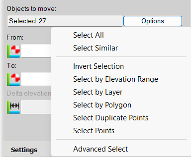

    From my understanding you can't start a TBC function from within a macro.
    If you use the "MemberSelection" as suggested in my previous post
    In the UI XAML
        <Wpf:MemberSelection x:Name="objs" Height="30" Margin="0"/>
    You can activate the options menu there, as shown in the TBC sample macros.
    in the macro in OnLoad
            optionMenu = SelectionContextMenuHandler()
            # remove options that don't apply here
            optionMenu.ExcludedCommands = "SelectObservations | SelectPoints | SelectDuplicatePoints"
            self.objs.ButtonContextMenu = optionMenu # set what is visible when clicking the option button
    Screenshot from an old 4.xx TBC version, just as example, don't have a dongle currently
    Includes more mouse clicking. You weren't clear on how automated you want the process.

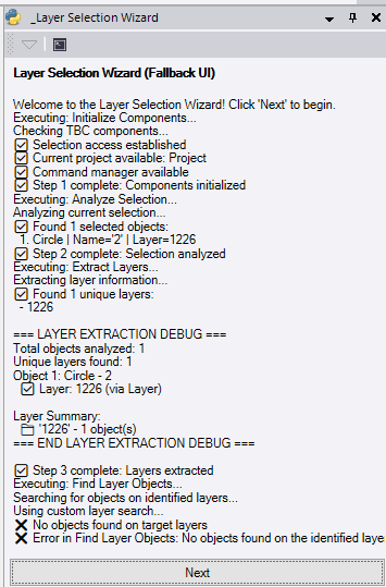

    Below is my current code, but it cannot fetch layer data from the object.
    Output/Error
    Selection.py

        def OnLoad(self, cmd, buttons, event):
            """Called by TBC after the panel is created"""
            # Store command manager reference
            try:
                self.cmdManager = cmd
            except:
                self.cmdManager = None
            # Re-establish selection access with command manager context
            self._establish_selection_access()
            # Initialize the wizard
            self._initialize_wizard()
        def _initialize_wizard(self):
            """Initialize the wizard interface"""
            self._update_step_display()
            self._update_status("Welcome to the Layer Selection Wizard! Click 'Next' to begin.")
        def _update_step_display(self):

        def _step1_initialize(self):
            """Step 1: Initialize and check components"""
            self._update_status("Checking TBC components...")
            # Check selection access
            if self.selection_accessor is None and GlobalSelection is None:
                self._update_status("❌ No selection access method available")
                raise Exception("Cannot access TBC selection system")
            else:
                self._update_status("✅ Selection access established")
            # Check currentProject
            if self.currentProject is None:
                self._update_status("❌ Current project not available")
                raise Exception("Current project not available")
            else:
                proj_type = self.currentProject.GetType().Name
                self._update_status(f"✅ Current project available: {proj_type}")
            # Check command manager
            if self.cmdManager:
                self._update_status("✅ Command manager available")
            else:
                self._update_status("⚠ Command manager not available (some features may be limited)")
            self._update_status("✅ Step 1 complete: Components initialized")

        def _step4_find_objects(self):
            """Step 4: Find all objects on the identified layers"""
            self._update_status("Searching for objects on identified layers...")
            # Try TBC native command first
            if self._try_native_select_by_layer():
                self.objects_on_layers = self._get_selected_objects_multiple_methods()
                self._update_status(f"✅ Used TBC native command, found {len(self.objects_on_layers)} objects")
            else:
                # Use custom implementation
                self._update_status("Using custom layer search...")
                self.objects_on_layers = self._find_objects_on_layers(self.layers_found)
            if not self.objects_on_layers:
                self._update_status("❌ No objects found on target layers")
                raise Exception("No objects found on the identified layers")
            self._update_status(f"✅ Found {len(self.objects_on_layers)} objects on target layers")
            self._update_status("✅ Step 4 complete: Objects found")

        def _debug_components(self):
            """Debug helper method to inspect selection access and currentProject"""
            self._update_status("=== COMPONENT DEBUGGING ===")
            # Debug selection access methods
            self._update_status("Selection Access Analysis:")
            if GlobalSelection is not None:
                try:
                    self._update_status(f"GlobalSelection Type: {GlobalSelection.GetType()}")
                    import System.Reflection as Reflection
                    members = GlobalSelection.GetType().GetMembers(Reflection.BindingFlags.Public | Reflection.BindingFlags.Static | Reflection.BindingFlags.Instance)
                    member_names = [m.Name for m in members if not m.Name.startswith('_')]
                    self._update_status(f"GlobalSelection Members: {', '.join(sorted(set(member_names)))}")
                except Exception as e:
                    self._update_status(f"Error analyzing GlobalSelection: {e}")
            else:
                self._update_status("GlobalSelection is None")
            if self.selection_accessor is not None:
                try:
                    self._update_status(f"Selection Accessor Type: {self.selection_accessor.GetType()}")
                    self._update_status(f"Error analyzing selection accessor: {e}")
            else:
                self._update_status("No selection accessor established")
            # Debug currentProject in detail
            self._update_status("currentProject Analysis:")
                self._update_status("currentProject is None")
            else:
                try:
                    self._update_status(f"currentProject Type: {self.currentProject.GetType()}")
                    members = self.currentProject.GetType().GetMembers(Reflection.BindingFlags.Public | Reflection.BindingFlags.Instance)
                    self._update_status(f"currentProject Members: {', '.join(sorted(set(member_names)))}")
                    self._update_status(f"Error analyzing currentProject: {e}")
            # Debug current wizard state and found layers
            self._update_status("")
            self._update_status("Wizard State Analysis:")
            self._update_status(f"Current Step: {self.current_step} of {self.total_steps}")
            self._update_status(f"Wizard Completed: {self.wizard_completed}")
            self._update_status(f"Initial Selection Count: {len(self.initial_selection)}")
            # Debug layers if we've reached step 3 or beyond
            if self.current_step >= 3 and self.layers_found:
                self._update_status("Found Layers Debug:")
                self._update_status(f"Total Unique Layers: {len(self.layers_found)}")
                for i, layer in enumerate(sorted(self.layers_found), 1):
                    self._update_status(f"  {i}. '{layer}' (Type: {type(layer).__name__})")
            elif self.current_step >= 3:
                self._update_status("No layers found yet (may indicate extraction issue)")
            # Debug objects on layers if we've reached step 4 or beyond
            if self.current_step >= 4 and self.objects_on_layers:
                self._update_status("Objects on Layers Debug:")
                self._update_status(f"Total Objects Found: {len(self.objects_on_layers)}")
                # Show first few objects as examples
                for i, obj in enumerate(self.objects_on_layers[:3], 1):
                    obj_info = self._get_object_info(obj)
                    self._update_status(f"  {i}. {obj_info}")
                if len(self.objects_on_layers) > 3:
                    self._update_status(f"  ... and {len(self.objects_on_layers) - 3} more objects")
            elif self.current_step >= 4:
                self._update_status("No objects on layers found yet")
            self._update_status("=== END COMPONENT DEBUGGING ===")

    I feel like I am poking in the dark trying to find the proper attribute name by sheer luck.
    Any help is appreciated.,
    Eero Isola
