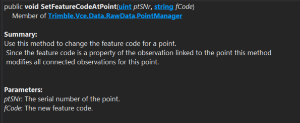

Creating new codes with the following (haven't used it yet)
pm.SetFeatureCodeAtPoint(uint ptSNr, string fCode)
